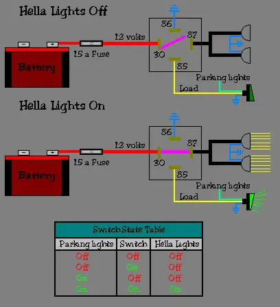

It is generally not recommended to run HIGH power through the switch (and in the cabin). Yes many cheap light kits don't come with Relays, and to make matters worse they usually have small wires and crappy socket designs that make poor contact causing sub par/intermittent performance. It sounds nice to save some $$ on lights, but if they perform poorly you aren't saving anything. All quality lighting kits include a 12v relay to provide power to the lights.
The purpose of using a relay is:
  • Keeps the High power wire as short as possible for efficiency.
  • Keeps the High power out of the cabin for safety.
  • Doesn't introduce added electrical interference to the cabin.
Typical wiring diagram for fog lights.

Trust... your vehicle is full of relays. I believe all your lights (diff gen) have relays, there's a reason why -
...i dont exactly understand how a relay would help though, wouldnt the same load run though the wires to the switch with or without a relay?
The relay, or lack thereof wasn't your problem, but is recommended for the reasons stated above.
The whole purpose of relays is to keep the trigger/switch wires/circuit separated from the load circuit. As such the switch and load circuits never contact each other. The switch wire typically is <1amp, while the load is 30amp.
