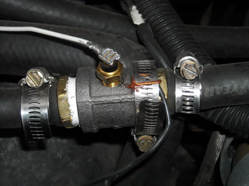

Here is a pic of a sending unit with the "flat" thing on top.. And you can see how we ran a wire to it to ground it. We "made" the hose fitting so we could put the sending unit where we did. This was on a vehicle that got an electric fan. On our X, I used a store bought host fitting but I didn't have the ground wire issue since the sending unit I used was a 2 wire, meaning it has its own ground.

My only question now though, is how do you ground it? It looks like in your picture, you just connected a wire to the piece of metal you installed the sending unit (not the actual unit itself, but the adapter it's plugged/screwed into) to the body. Is that how you did it?
Yup, thats all we had to do.. As long as the body of the sending unit is touching the grounded metal the sending unit is grounded. Thats why many sending units say not to use teflon tape. If you use too much the threads won't cut through the tape and you won't ground the sending unit. We used teflon paste to seal the threads instead of teflon tape.
