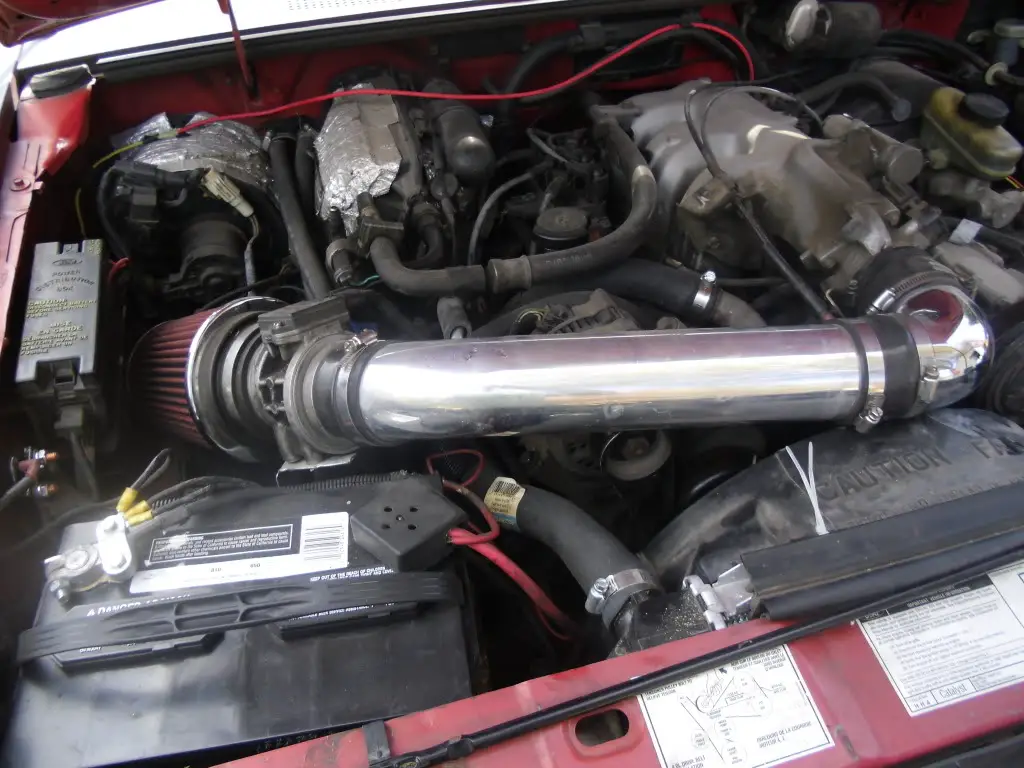

I made mine for less than $50:
302 mass air flow housing with 4.0 sensor guts
I got most of it for free, the main tube is from a 90-93 integra, 2x6 hanger cut fabricated to brace the mass air flow sensor. Then there is a spectre air filter, and one 90* bend to the throttle body.
I picked up a 302 MAF from a junkyard, removed the guts, and installed the stock 4.0 guts. Some people say this causes issues, however this has been on the truck since 4-2011 and I have had ZERO issues with drive-ability or running rich condition. I have cleaned the sensor once a few months ago.
So you think moving the intake into the hot engine compartment, right behind the battery where there is almost no airflow, was really an improvement over the stock system that sucks cold air from behind the grill?
As I have stated I simply did this because I could. I understand there is no real performance gain, if I wanted performance there would be a 302 in here instead of my tired v6.
I was giving an idea to someone else, I don't need YOU to criticize my work. If you or anyone else on this forum doesn't like my idea, try constructive criticism and give some ideas of how to do it better, not telling me how my way sucks etc etc etc.
I never said my idea was perfect or worked flawlessly. How many inventions failed before the inventors got it right?
Have you looked at how the stock intake takes in air? It's not just about hot vs cold(cool, ambient) air.

In my experience, Surf has it right.
"Easy there Francis"- I can see you have a hood clearance issues because of the wear marks on your fan shroud-- if it wears through your pipe will hit the fan- you might consider a bracket of some kind.
I have all the intake/exhaust mods listed above and headers-- maybe a little (maybe) a little improvement. Not the amount I was hoping for. 4:56 gears and a doubler was the best improvements ever.
Without spending allot of money the explorer is not a sports car so it will not perform like one.
If everything else runs right, the KKM and cat-back exhaust give pretty big gains for the cost.
Most of the time, people expect mods like an air intake to 'correct' problems, and it doesn't give a big bump in performance because the engine needs regular maintenance items just to get back to stock performance first.
If you add a LOT of performance items, you should be tuning with a chip anyway. Just a better flowing intake and exhaust is within the capability of the stock ECU.
I only had one wear spot from the git go, which was the alternator. I have a 2x6 hanger holding it up after several tweaks to get it the way I wanted. I haven't noticed anymore issues in the last year and a half.
**Just a footnote here-- I obtained 90 percent of the intake materials for free, as in I saved them from the garbage can. This was a chance to see if I "COULD" make an intake and how well it would work. I did a crap ton of reading and understanding that an aftermarket intake won't do crap for performance gains.**
This is why I got so frustrated at the posting, that I perceived as bashing regarding my creation.
By all means is someone else has a better way of doing things enlighten me and educate me how to do it better.
If anyone else got offended, well I will apologize.
