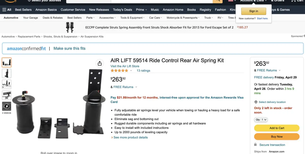

amazon USA (amazon.com) has it... but i notice the canadian amazon does not! have you tried the USA amazon? perhaps you can get it shipped to a forum member on the east coast USA who can forward the part to you! try changing the .ca in the URL to .com
we tried amazon, they do not know when it will be available.
look at the PDF attached file
thats odd! on my end its available! maybe its a delivery location issue
Delivery location issue will be the key point, but i will not give up.
Regards from a very litte town in Germany to the United States of America!
Wolfgang
