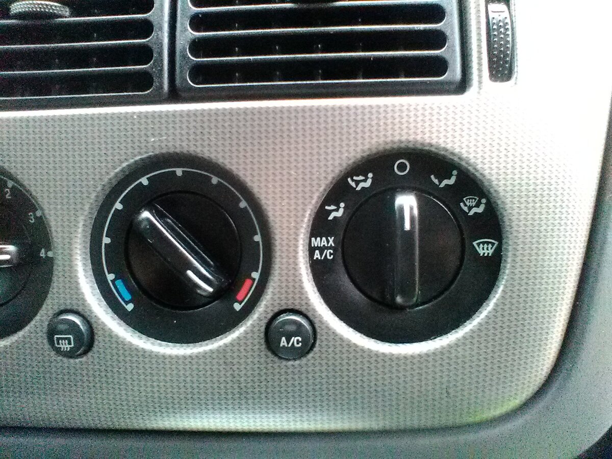

Whether its hot or cold, the air will only flow out of the vents in the dashboard.
No defroster, no feet.
Any common issues/problems which may be causing this?

1). Air constantly blows out of the lower/feet vents regardless of which direction you choose.
2). The motor/arm/actuator which controls the vent door only has two positions: fully extended or fully retracted, thats it, regardless of which selection you choose. If you turn the selector to the right, air will exit from the top and bottom. If you turn it to the left, air will exit from the dash and bottom.
