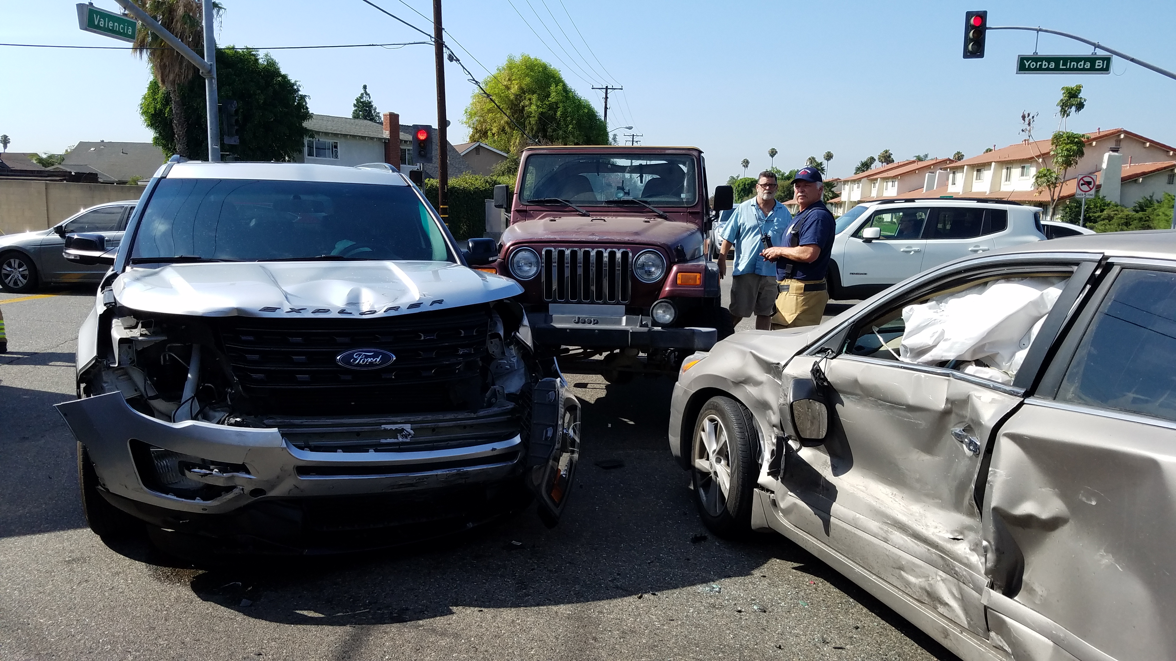

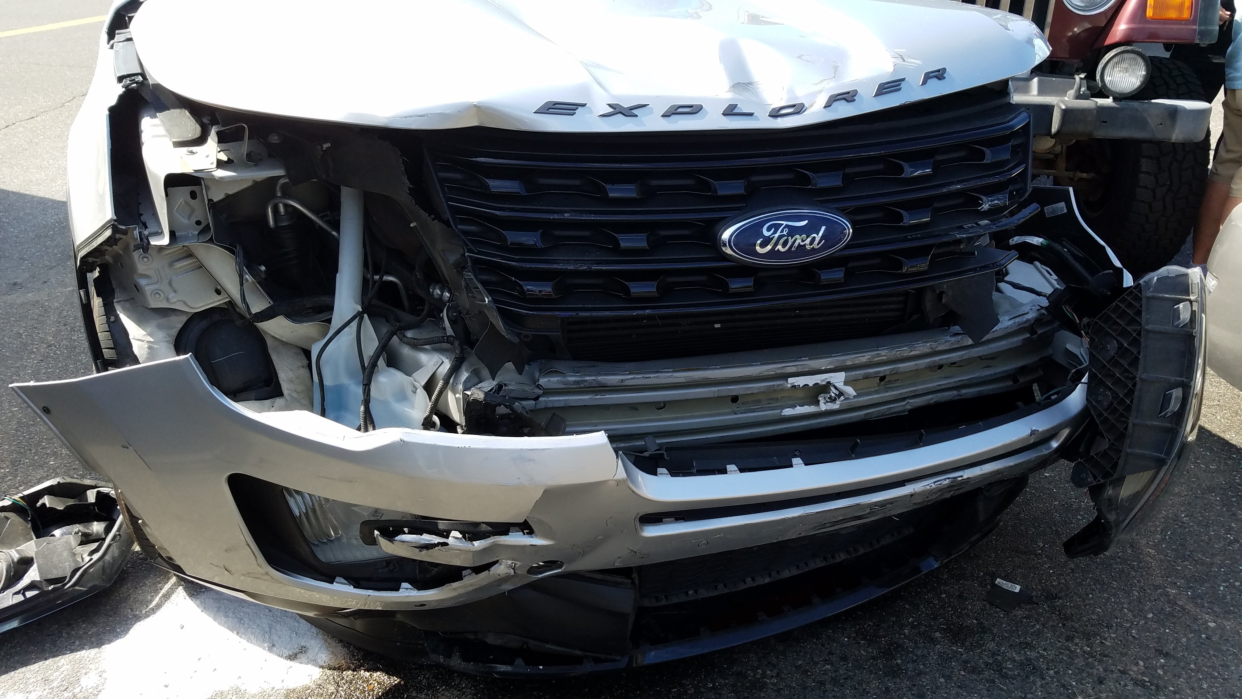

This is my first time posting and unfortunately I am posting about my 2016 Explorer Sport after a nasty wreck. My airbags did not deploy when I had a collision with a Toyota Tundra and just by looking at it, I thought it would have easily deployed. I was going 10-15 mph making a left turn at the intersection and the other driver was driving around 50 mph when he appeared from no where. He said he was going straight but the tire marks show he was coming from a turn lane. Anyhow, we came close to hitting head on but he was turning and avoided the head on. I walked away with just a bruised knee so I am very thankful and blessed. I am attaching a picture of the damage below. Please let me know your thoughts as to whether the vehicle just crushed in a way that prevented it or if I should be concerned. Someone will look at it in the next couple of days at the body shop still.
Holy crap....I would think they should have deployed in this situation based on his speed and the damage. Wow...
That's probably a total, depending on your insurance. Glad you are ok.

It is unfortunate this had to be your first post but fortunately, you are okay. I believe the airbag should have triggered. I also believe some of the sensors are located within that tangled mess.

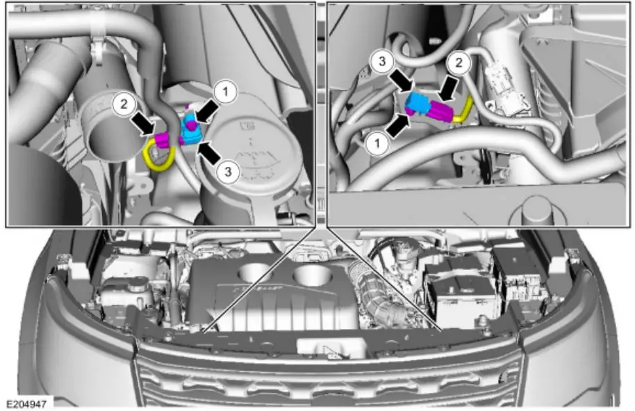

Impact severity sensors are actually more in the engine bay behind the grille.
The RCM makes a decision to deploy the bags based on a number of calculations--impact sensors are just one input.
It has a number of plausibility checks--and it's only going to blow the bags when they'll save you. Given the damage and what was probably low deceleration, the airbags were probably more likely to injure than save you. Given the internal checks that it undergoes--an undetected failure would be exceedingly rare. There are actually types of crashes that will blow side airbags even though it was a front crash, etc.
I suspect it may have done it's job just triggering the pretensioners to limit forward movement, if that even occurred.
Don't sweat it in short, the car did its job.

Although the front looks messed up if you really look at it, the passenger headlight is intact, the grill looks intact and the hood looks intact. Really it is just the bumper and associated wiring that fell off.

Frankly based on the front end, I think I'd be glad the airbags didn't go off and based on your injuries, sounds like besides being a little sore, everything worked as it should have.

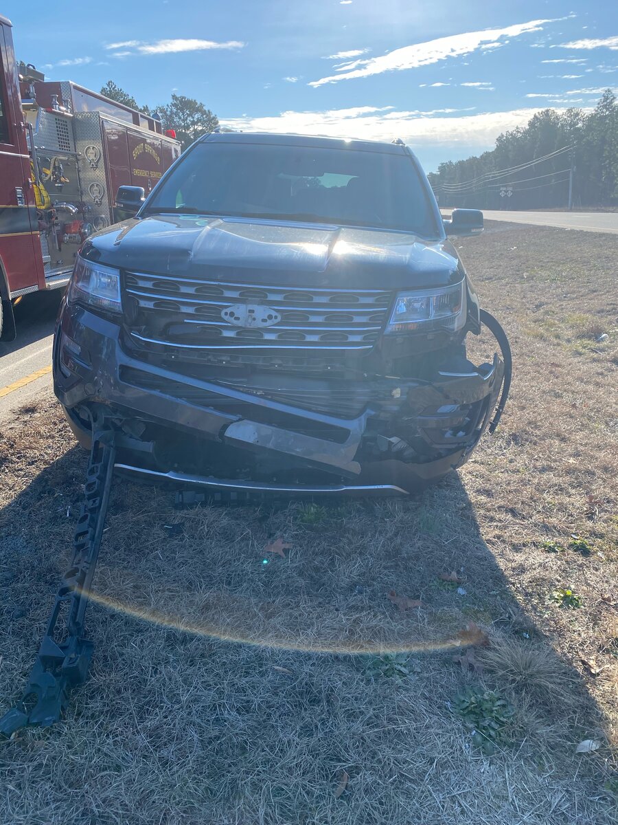

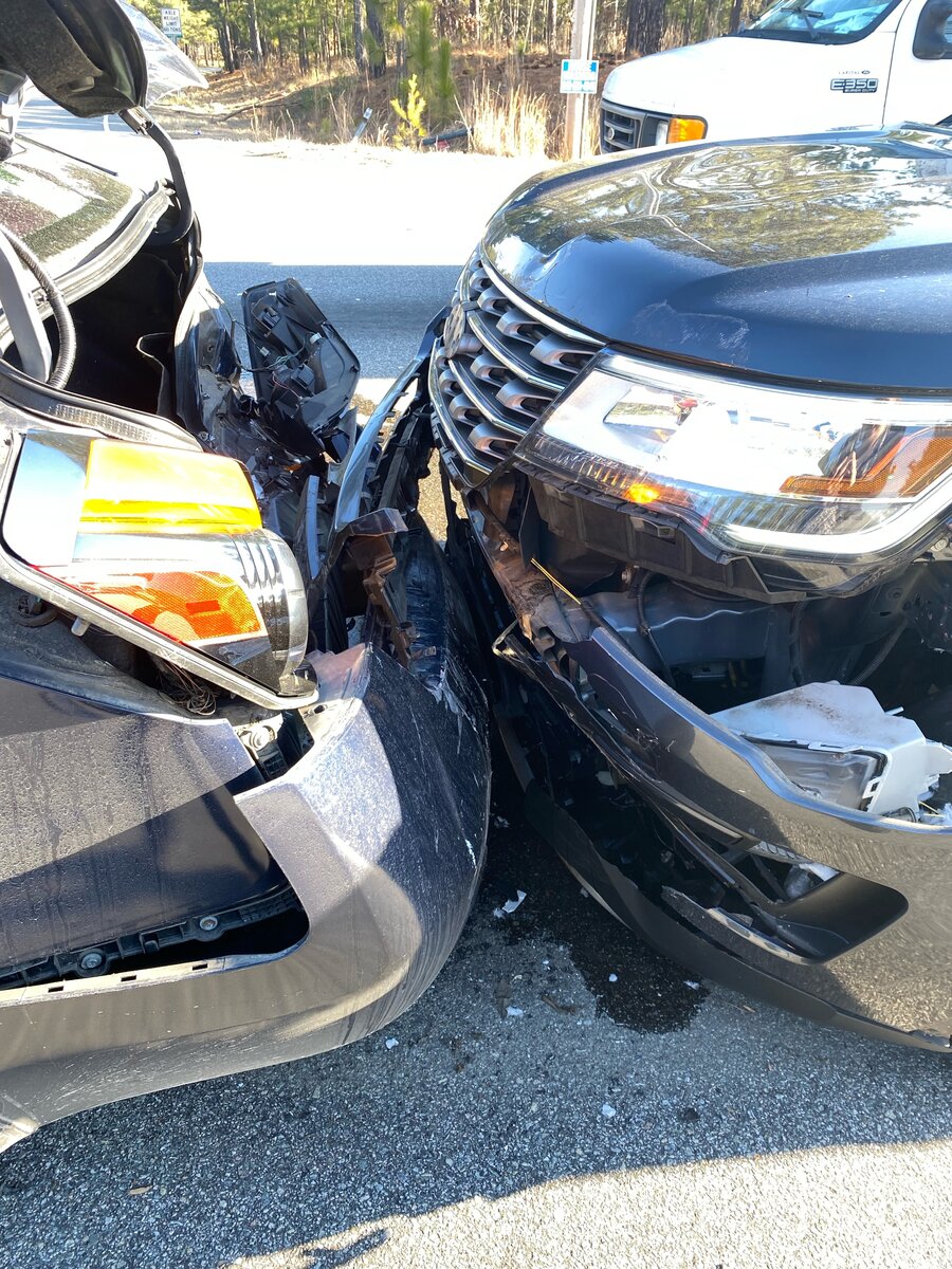

Yesterday I hit & destroyed a Nissan. I was going about 35-40 mph. No air bags went off on my 2017 Explorer. Me and the driver of the other car are ok. Both were able to walk away with no injuries. Accident happens in Spring Lake, NC

Glad your ok, extremely surprised not one airbag deployed.
Also glad you're OK. Perhaps even a frontal collision relies on the angle of impact to deploy airbags? I wonder. I wouldn't want one going off in my face, just saying. Unless of course it was life-saving!
