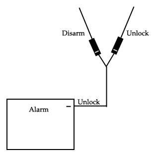

My alarm doesn't have a factory disarm..
If it doesn't have a factory disarm wire, then the factory alarm might still go off when you open the door. You can diode isolate the the unlock wire and hook it up to unlock like you were going to and also hook it up to your disarm wire.
Quick sketch:
