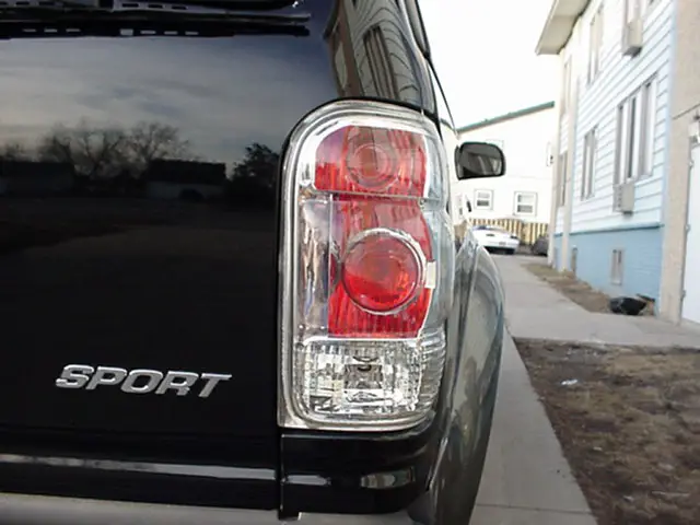

Followup: Since siliconing around the seal completly and taping around where the bulbs screw in I get slight fogging right after a carwash but it goes away within hours and everything is fine now. No leaking like before......I think this is the best yet. But now I think I want carbon fiber tails. This 50+ mail carrier at my job asked if that was my truck in the parking lot w/ the clear taillights...when I said yes he was impressed I was customizing it. Then he went on to say.....yeah, what do they call that....ric....rice...ricing it out..that's it.....just like those Toyotas and Hondas.....

Sarah: got any pics of what you did to them, i would like to do the same. and dont ya love it when people make nice comments about your ride like: i cant beleive you did that to an explorer, thats the coolest explorer ive seen. people not from the site i mean.
Not right now but I can snap some tomorrow, everyone knows I love taking pics. Heres a close up of the tails looking nice and clear like they should.
If you have a good eye you can barely see the silicon on the left side of the seal, less noticable then the water hehehehe.

Those look good to me!
