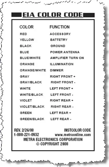

I've been looking at upgrading my speakers and sub/amp, and I came across this "diagram" for the Metra 70-5521 (Factory amplifier integration harness), so the color codes should be accurate:
From what I gather, you'll want to tap the blue/white wire as the remote power on for your amp. And jimster502 is right, you should have a separate RCA Out for the sub.

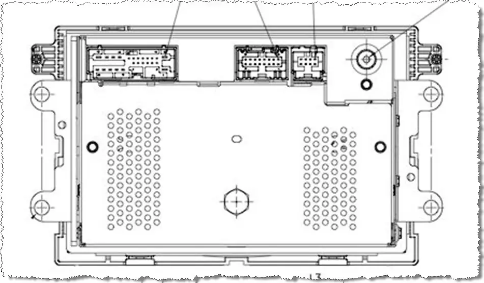

I looked at the back and there is no rca plugs that I see, just two wire harnesses/plugs that are connected to the radio. I got an 800watt amp with line lvl inputs so I think I can just strip the wires from the back harness and run them to the amp. Where is the hole in the firewall? And a good grounding area near the trunk? I have to also run the remote wire too. I'm thinking of installing it tomorrow.
I looked at the back and there is no rca plugs that I see...
Darn it, now I can't find the thread where the RCA plugs were mentioned and everything I come across has no mention of RCA plugs either.

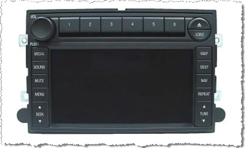

Just to make sure, we are talking about this head unit, right, whihc is not showing any RCA out:
Yup, that is the head unit.
