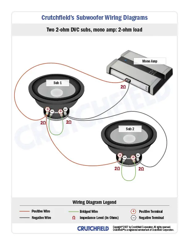

edit: what ohm are you running the subs at? at 2 ohms it would actually be ok.
I think Im am runnign at 1 ohm but I am not sure.
They are kind of ran like that but it was a 2 channel amp so I had it bridged. Far + side and the other was on the far - side.

Are you sure of the RMS values you posted above? I just want to make sure I am not going to suggest something that will blow your subs haha. Also how you are running them i.e. 1 or 2 ohm makes a big difference.
Well I guess according to that diagram I am runnign at 2 ohms. I just bought the amp last night though that should do the job. HIFONICS BXi1606D 3200 WATT CLASS D MONO AMP AMPLIFIER.
