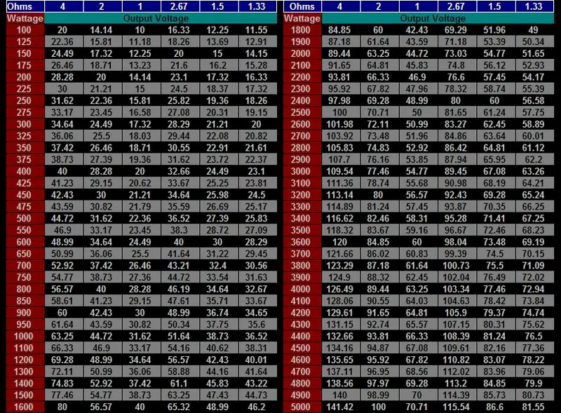

Got all my gear installed "professionally" but I'm convinced the guy didn't tune my amp correctly....when I got in, the "bass boost" control was cranked all the way up...and it sounded like ****.......but if I turn the "bass boost" down all the way....my sub cuts out completely....not how I understood it to work.
I would like to be able to tune it myself using my multimeter....but I'm not certain what values to shoot for.
Front channels Speaker RMS 60W Amp RMS 70W
Rear channels Speaker RMS 50W Amp RMS 70W
Sub channel Woofer RMS 300W Amp RMS 210W
Can anyone point me to a guide so I can do this myself....thanks.
Also....is there anyway to have my SVC 4 ohm sub present a 2 ohm load to my amp.....without having to add another 4 ohm sub
