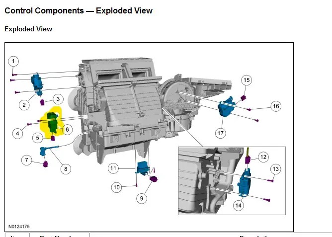

The issue I am having is that the Driver side air is not as cold as the passenger side, I replaced the Drive side bend door but no luck. still the same, its not completely hot when the AC is on it is just warmer on the driver side compared to the passenger side. Its like the blend door is half way on the driver side. ie getting a mix cold and hot. If I put the heat on , its warm on both sides.
I replaced the actuator highlighted in Yellow. Is there anything else?
I even tried resetting the HVAC using the power and defrost key combo
Is that actuator for the Left Hand side?
Peter
Yes on the driver side
Perhaps the door isn't closing completely. I'm not sure if it is adjustable. I thought I read a post by a member that mentioned that he had to readjust the actuator position in order for the door to close completely. That was a few years ago.
