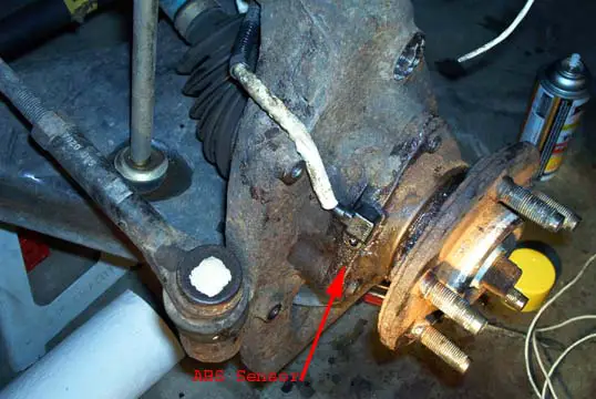

Yeah, the dirt build up might be doing it. My wifes 2005 Pontiac Grand Prix GTP was doing that and I took off the driver side front wheel too check the brake pads and they looked good so I put everything back together and that fixed the problem...although I swear it still does it lightly (I do not drive the car much)...might be the otherside...while under there all I did was blow off all the brake dust built up.
It is a free fix (worth a try), better then going to the stealer.
Here's a picture of a second generation front ABS sensor from V8BoatBuilder's photo gallery:
