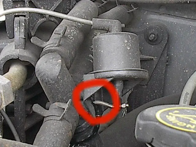

Hey, here is where it is leaking from. Not sure what this part is called, so any help would be great. I just started the truck and pulled it around the garage to the driveway to start on my locker and this happened, any ideas how i can fix it quick?!! Thanks.

Is that your Heater Control valve?? They do leak and are pretty easy to replace.
Very common problem. It's your heater control valve. Normally the fix is to replace it. If I remember right, it's around 60 bucks.
Looks like the heater control valve. Mine started leaking a few months ago and I replaced it in about 10 minutes in the Autozone parking lot. Simple and cheap.

I'll check on that part tomorrow, thanks a bunch guys!
