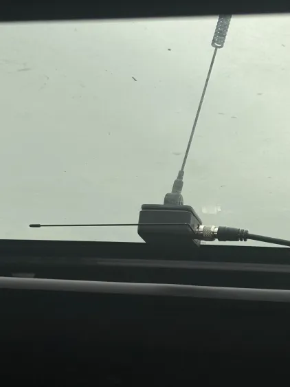

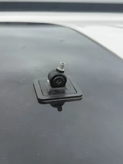

I use a Tram 1192 U/V thru-glass glue on window antenna, mounted on the moon roof. SWR is below 2.5:1 on all the frequencies I care about, and below 1.5:1 on the ones I *really* care about like GMRS and MURS. I get good signal reports and pull in a decent signal, although it isn't the cleanest I've heard. Coax run thru headliner, down A-pillar under door sill, under driver seat. It whistles a good bit at high speeds, but some heatshrink (or scotch tape, if you're on a cash/time budget) wrapped around the coil fixes that right up.
Radio is a 578 just stuck between the driver seat and console, although you could use the BT-01 remote head (wired or Bluetooth) and mount the radio elsewhere. BlaydeFab also makes a faceplate relocation kit, although it is limited to 36 inches because of the analog signals sent over the cable.

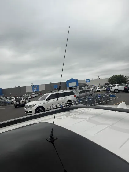

Really did everything I could to avoid drilling a hole. I'll have to eventually, because I need more antennas :3 but for now this has done a fantastic job.

They really are surprisingly good. Unfortunately, I can't stick with it forever, since in order to park in my garage the antenna has to come off. I will eventually be resorting to stubby/stealth/puck/whatever antennas that are only a few inches tall in order to be able to leave the antenna permanently mounted to the car.
I really wish there was a radio comparable to the 578 in features that had a remote head option, so that I could get it out of where it is now. Soon, I'll be acquiring a BT-01 bluetooth/wired mic and relocating the unit to the very back of the car.

I didn't want to have a cable getting pinched by door or hatch run into the cab. I also didn't want to scuff a hole in the clearcoat on the roof.
