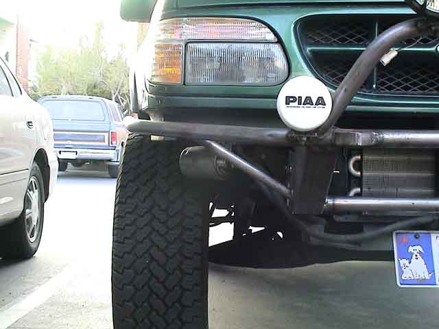

mctoy said:
Speaking off the filter issue, Al, how is changing your oil now with the relocation (Up front)...Watching your success (Or failure) B4 doing it to mine.
I relocated my filter (see pic below). It's right in front of the wheel and the phrase "easily accesible" is an understatement. Oil changes take 5 minutes, and most of htat is waiting for it to drain...
