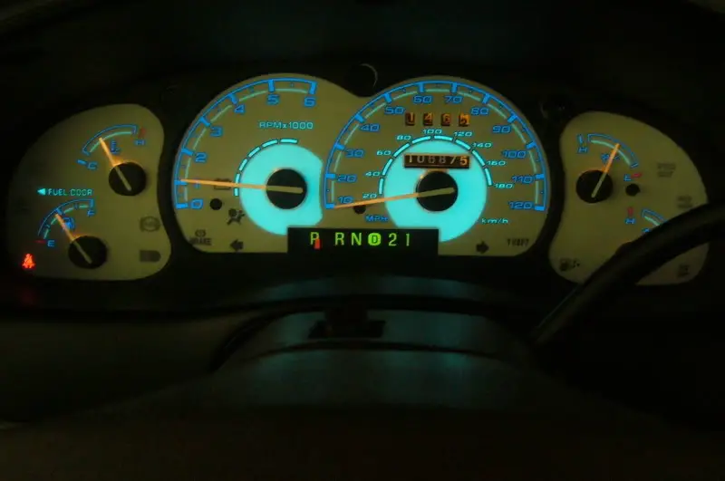

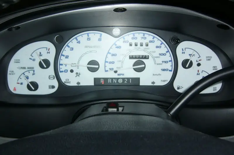

Daytime:
Nightime:
Im getting some red wedge leds for the needles and a shift indicator from an 01 sport for the white face indicator so the P RND21 light up red. Soon all my interior lighting will be matching blue!
