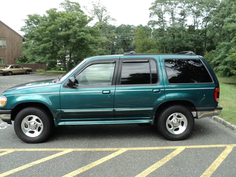

I did some searching in the Tires & Wheels area but didn't find this mix so I figured I'd just ask. I have a friend who will make me a deal on some Goodrich All Terrains that are off his Rubicon. So has anyone run a 255/70/16 on a stock Explorer of the '01 generation? My truck cam stock with 245/75/16 tires and I think the rims are 7" wide but I'm not positive on that.
I don't want to do any thing other than mount them so if they won't work with no modification, I'll tell him I have to pass.

I don't think the Jeep rims will fit. I believe stock Rubicon wheels are 5x5 bolt pattern. Your Explorers stock wheels are 5x4.5, so not a simple bolt on without adapters. If you're just using the tires, 255/70-16 tires on stock Ex rims no problem, I run them on my '98.
Yeah, I already tried the rims, the bolt pattern is ok but the rim actually hits the brake caliper.
What I want to know is if anyone has mounted these tires on the stock 16" Explorer rims...
Like I said, I run them on my '98.
So do they "puff out" and get close to rubbing the upper control arm? That was my biggest worry
By the way, Sweet looking Explorer - I wish mine was still that shiny!
Thanks for the compliment, that's still the original paint. I've never had any issues with rubbing. 255/70-16 was an optional tire size on later 2nd gens.
Great to know, thanks! I'm going to lay claim to the Rubicon tires today!!!
