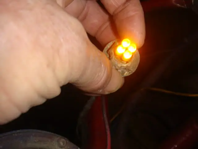

OK, went out and found one bulb that would flicker when I took my hand and beat on the front fender. Now when doing trail rides or hitting bumps in road, you can only imagine how many times it would flicker :rolleyes:
Now had I not beat on side of fender, I would have never had known that it was flickering, cause it would come on when the truck was sitting still.
Now remember that this socket is on an 84 B2 and sees it's share of trails.

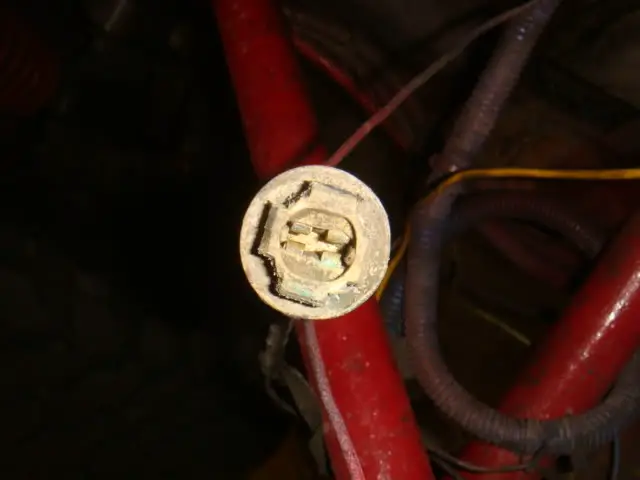

Notice the air space between the copper conductors. This is too wide, does not make contact well enough when being shaken.
But before fixing the gap, this would be a good time to clean those conductors with some fine emery cloth.

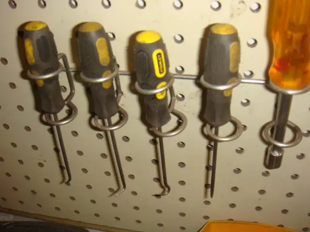

Next take out your set of these nifty little things with all the different bends.
If you don't have a set and your a self proclaimed DIYselfer, then you need a set.

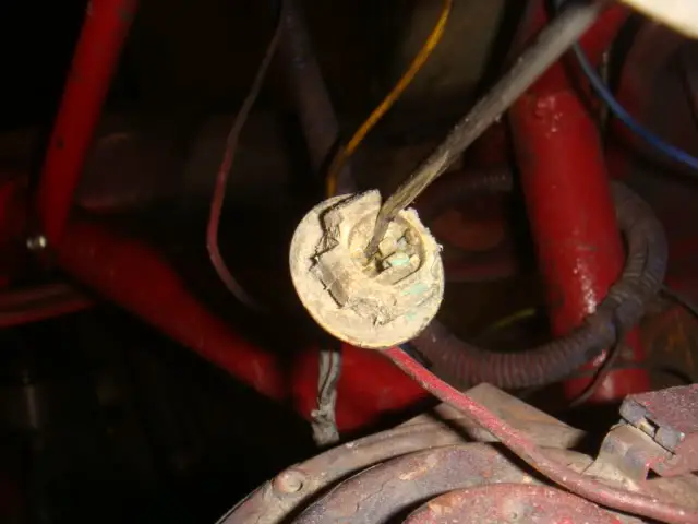

Then take the appropriate pick and insert behind the copper electrode and move toward center.
Make sure the switch is off.

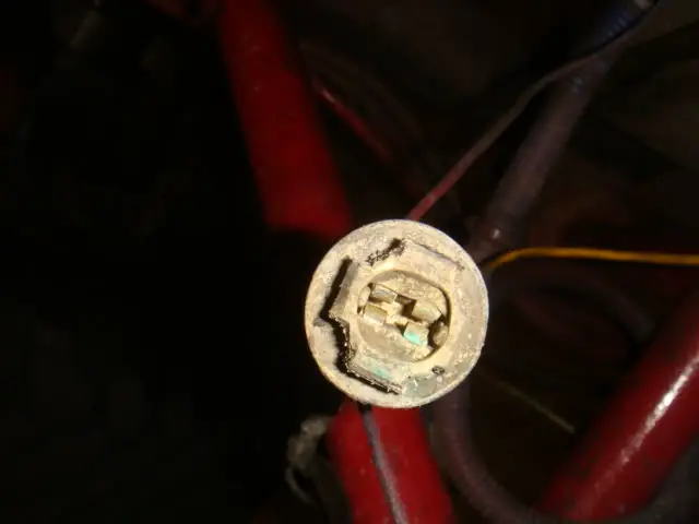

Untill the gap looks like this or even closer.
Now the Old finger flick Test. Walla, no more flickering. :cool:
