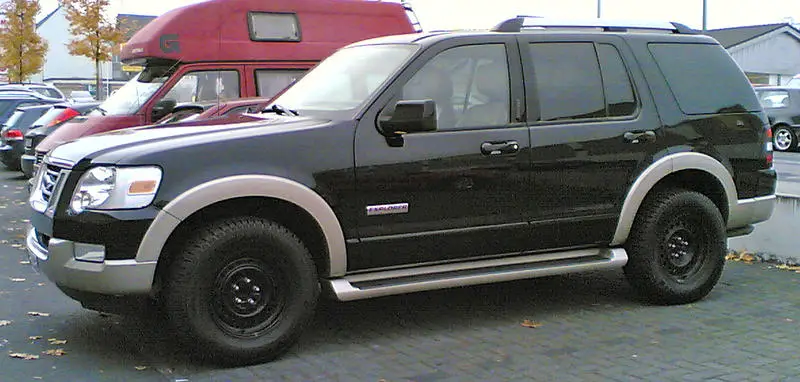

I think I'm about to get some 255/70R16 General Grabber AT2s, and I would really appreciate it if anyone has any pictures of their Explorer with any tire that is that size. I want to know somewhat what to expect before I get them. Thanks.
With 16" steel wheels of second generation Explorer. Their normal tire size is 255/70 R16. The wheels have an ET of 12, so they come out about 30mm (1.2 inch) more than stock.
Those look really good, thanks for the picture. The 4th Gen should have come stock with tires that size. I think I'm going to get the tires on Thursday or Friday, so I'll take some pictures once I get it done.
