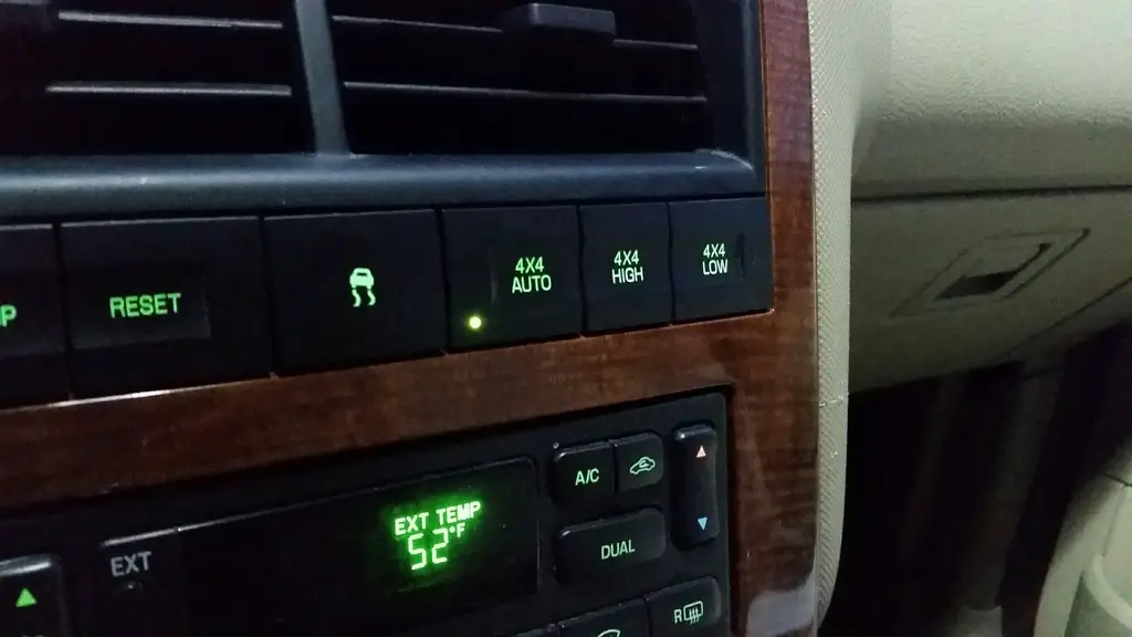

Instead of putting a toggle switch on it, I wanted to make it work more seamlessly with the buttons that were already there. I wanted to basically toggle Auto-4x4 on and off, so it made sense to me to use that button. Exactly how I feel FORD should have done it in the first place. What I ended up doing is using a simple circuit to turn a momentary switch into a latching switch. The buttons in the Explorer cant be tapped into directly, unless you build a logic circuit that can read different resistances and act on one specific value. That was too much for me to mess with, so I went with the simple mechanical route.

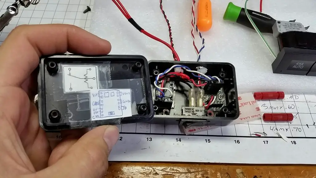

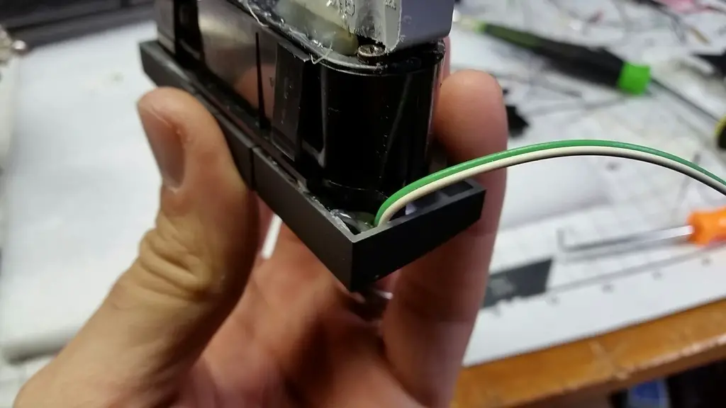

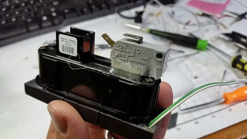

Here are a couple of pictures of the set up. Below you will find a video demonstrating how it works. The second half goes into more detail about the circuit and how its hooked up. This could also be used in older models, or anything that has a system that you can disable by disconnecting a single wire. If you have any questions let me know!
Micro-switch glued to the back of the stock switch assembly.
This is the wiring for the LED. Decent amount of space to run the wires out.
Here's a tip. Any time you shove a circuit into a small project box like this, print out, or draw up the circuit diagrams and tape them to the lid. This way you have a quick reference if you ever need to service or adjust it. This is better than having to look it up, or remember where you put the diagrams.
This is the whole setup.
And finally this is how the switch looks when activated. The light is highly visible even in direct sunlight.

But basically, the Auto-4x4 button can be depressed without activating the micro switch that I added. If you press a little harder, you will feel the click of the switch that I added and you will trigger the system. The rod that I put in to activate the micro switch is trimmed so its triggering the switch just past when the Auto-4x4 button is closing its contact. It works pretty smooth.

tymeno: Sure. Let me put a list below:
Latching Switch Circuit - https://www.pololu.com/product/2808
Relay - (any relay will work, I used a radio shack version) something like this https://www.radioshack.com/products/radioshack-15a-12vdc-125vac-relay
Project Box - Again from radio shack. Ive had this laying around since the 90's...this is probably the 4th project Ive had in it. You can mount things however you want.
Rocker Switch - If you want to be able to bypass the system and just connect the wire like factory.
Thats about it. The momentary switch can be any switch you can find. This one was laying around probably for 10-15 years haha. LED is any 3mm LED that you can run on 12v DC.
I can try to draw up a schematic, but once you have the parts together its pretty easy.
J.

I didnt modify the actual switch much at all. Just drilled a hole for the LED to shine through, and attached the switch via a push-rod.
As far as I can tell, there should be no difference. Mine will push further on the left side of the switch than the right side, just because of the way its arranged. I dont think you could engage my 4x4 unit while pushing on the extreme right side of the Auto button. You can if you push harder in the center. And if you push on the left its very easy.
Remember, the micro switch only requires a small amount of movement to click over to closed. Also, you can pre-load the micro-switch so that it requires even less movement. I didnt want to do this too much, because I wanted to be able to work the auto switch without turning off my 4x4 mod. So I made it activate JUST past where the factory switch seems to stop. A tiny more force trips the switch. And I mean tiny...nothing will break.
