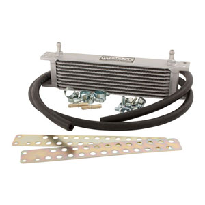

OK so I will leave the OEM cooler in place.
This is what I'm thinking of fitting (240mm wide, 10 row high) it's about the biggest one I can find at the moment in the UK, but will keep looking tonight.
out of interest how big is big?
cheers
jim

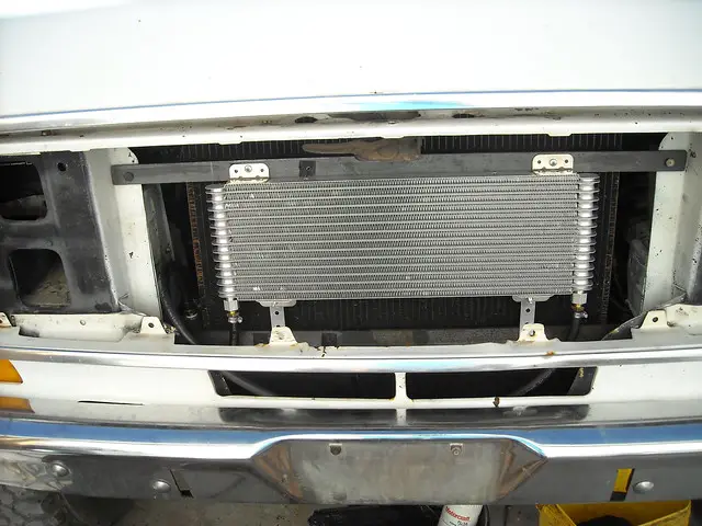

The biggest one I have found is the one I'm using on the tow rig. It is used as the only cooler and it keeps the pan temp of the c6 (somewhat cool running trans anyway) 160F or less even when towing up hill. Tow rig + trailer plus what I was towing came out to around 13k lbs.
Here is the cooler I"m using there.
Tru-Cool # LPD47391 40,000 GVW rating, 45,000 BTU rating
8 1/2 x 22 3/4 x 1 1/4 inch
Here is a pic of it. I "think" it might be a little big for an explorer. Its pretty wide and is 1.25" thick.
On our 1st gen X, I'm running two trans coolers. IIRC one is a 30k gvwr and the other is a 24k gvwr.. The fan is from a 92 Geo Prism/toyota corolla (a/c fan).
Its the most I could fit in there..
Most trans cooler I see in auto parts stores are < 15k gvwr coolers. It would help, but no where near enough to be the only cooler.
~Mark
