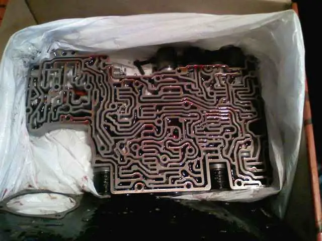

Pulled pan and valve body assuming it is related to that area.
Fluid was nice and red, transparent, and smelled normal, bottom of pan was clean for the most part except for a very light black greasy coating about the thickness of paper, and it was on solenoids too. Otherwise nothing else, valve body gasket is perfect, it already has the update gasket and kit, and all the solenoids Ohm within specs except for the EPC has been weird in that regard with Ohm readings, in order, 120,20,5.7, and 4.5 and it now seems to stay at 4.5.
I have seen where some say most seem to go bad anywhere from 60-80 thousand miles, but that would seem like its right on the dot for 60 thousand. The screen on the EPC is clean too. But it really would seem to be the culprit as low line pressure seems to be my problem.

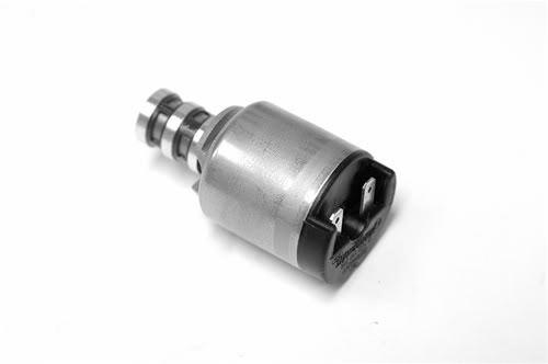

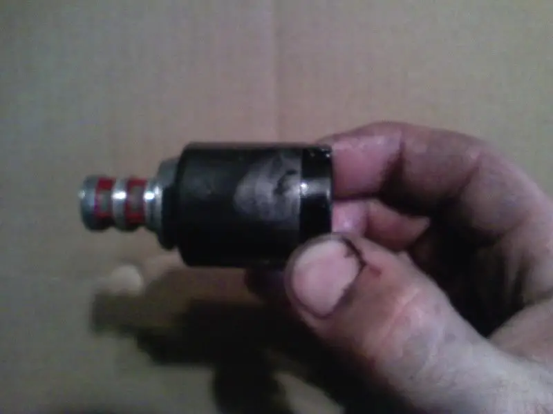

On the "Test EPC" any of ya'll remember what it look like? Is this it?
Let me know and I'll look into it some more.
The BW part is on the left. It is the one with a serial number engraved by hand into the side of the housing. The original EPC is on the right.
