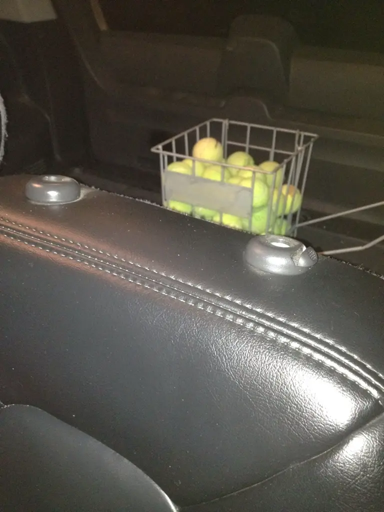

On my 2005 the rear seat headrests are held in with a spring clip. With a small flat blade screwdriver you would dig under the plastic guide carefully, so as not to cut the seat (leather in my case). Look closely and on one side or the other you'll see the spring clip held onto the plastic guide. Pry it back a little and the headrest will pull right out. Don't pull it completely out if you want to use it again - just a little bit.

Sorry for dragging this post up from the grave but I figured that there is a lot of good info in it and I only wanted to add a link to a line drawing of the grommet and clip mentioned in a post a few up from this one:
http://www.justanswer.com/ford/0zcjq-remove-rear-headrests-2002-explorer.html
The clips are under the plastic grommet, inboard side of each headrest post. you have to pry and pull the hole cut in the seat cover over the ears that hold the clip and the clip itself before the clip can be removed.
