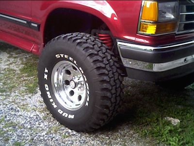

is any one on here running this type of rim on there x, if so post a pic
I am

any rubbing issues?
Yes, they hit the inner part of the fenders whenever i turn. Its not a serious issue for me but If i was to offroad i think i would tear they crap outta them.
