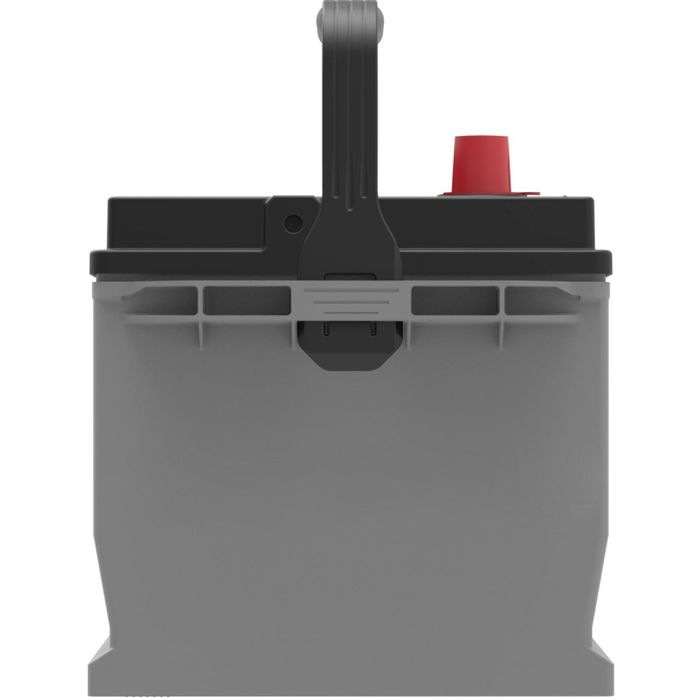

Get a Motorcraft from OReilly (or Ford) or a AGM Duralast from AutoZone.
http://www.oreillyauto.com/site/c/detail/MOT2/BXT65850/03321.oap
8
http://www.autozone.com/batteries-s...ery/duralast-platinum-battery/319465_929779_0
