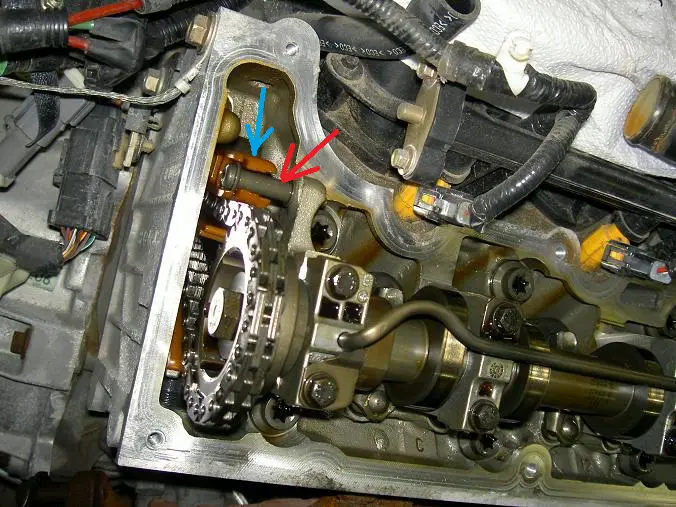

The traction side is the side that is pulled by the jackshaft. The slack side is the side with the hydraulic/spring tensioner. Try to pull up and push down the top of the guide assembly where the guide post is. There should be almost no vertical movement.

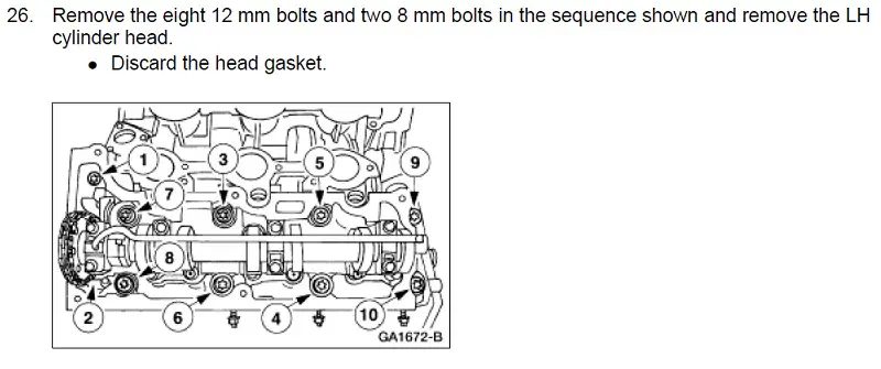

head bolt removal
In case you decide to remove the head:
Left and right heads have same bolt sequence.
I'm having a huge problem with car speak. I cannot locate the guide post unless it's just the 1/2 in dimple next to the chain. I moved that orange plastic piece from front to back (if that's what you mean by "up and down)" and it does move just a bit. No where near 1/8 of an inch. But it is not stuck in place by any means.

That image you provided I think is from your head removal guide? I've read a few and recognize that image. I believe your guide dealt with both heads. Before I even think about going there, I'm charging up a cheap camera so I can mount it and take video of what the valve springs and rockers are doing when I crank the starter. I still have no idea. I'll probably post the video somewhere and give you a link. I don't know what order they are supposed to go up and down so to speak. If it has anything to do with firing order, then I would need the left valve cover off too. Not going to do that.

The guide post is marked with a red arrow in two of the photos in post 19 of this thread. "pull up and push down" means move vertically. I try to be literally correct in my posts.
And I appreciate that! It's me who is half brained. But aren't you showing the left head in that photo? Because I can locate the pivot point on the right side head on my truck, but I cannot locate the guide post.
Don't worry about it, as I said, I'm not going to do anything with the timing chains unless I pull the head, and that's a 50/50 chance right now. Thanks again! -DW
The red arrow indicates the right head cassette guide post.
Pull up the guide at location marked with blue arrow.
Okay. No up or down movement there, only very slight from side to side as I mentioned before.

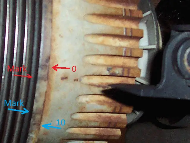

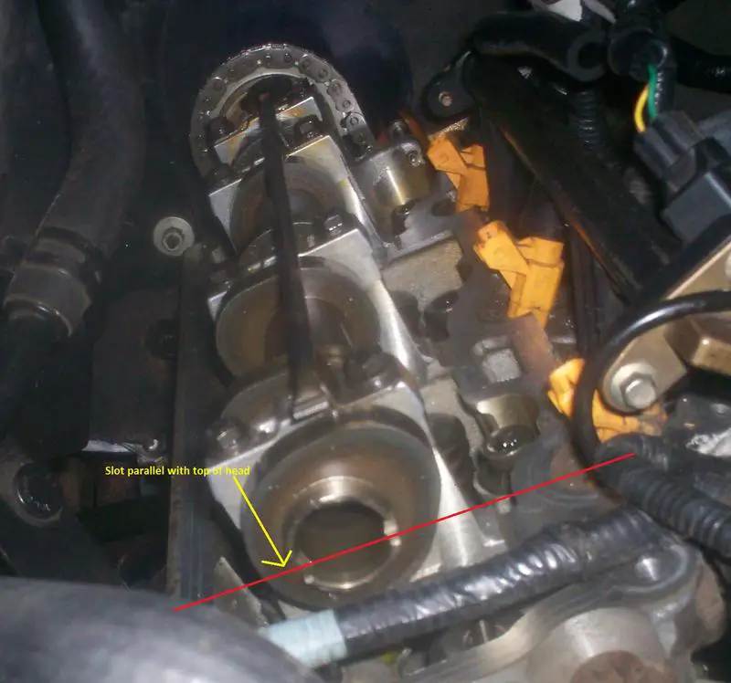

Hey again StreetRod - Just was looking through your posts on timing the cam, and wanted to know if my current cam position is correct so I can reference it if/when I do have to time it. The crank shaft at the CKP is somewhere between 10 degrees and what appears to be a 0 mark. I assume the 0 is TDC. The lobes were not putting pressure on the valves for cylinder 1, but I took all the rockers off just to be safe. Please let me know what you think ---Thanks! -DW

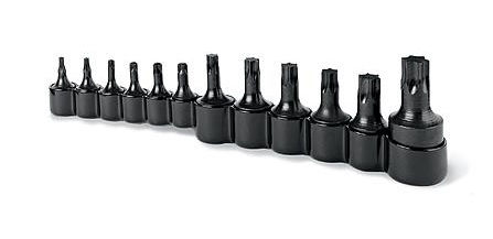

I believe the chain guide bolt is a T-30?, but the only T-30 I have is too long to even get the socket on it, let alone a wrench and socket. Thanks! -DW
timing marks
There are two timing marks on my camshaft: 10 BTDC and TDC. The lines are the marks and the number beside each line indicates which mark.

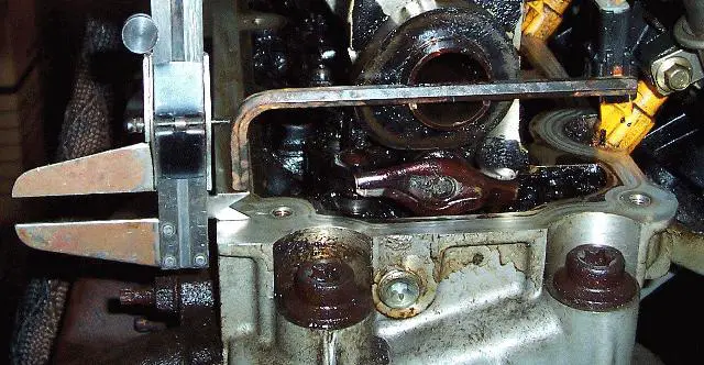

The camshaft timing slot position in your photo looks correct. I used an Allen wrench and calipers to measure mine.

I have a very short length 1/4 inch drive Torx set that I purchased about 20 years ago. It looks the same as the 1/4 drive bits of the set Sears now sells.

Ok, thanks for the excellent info. I live pretty far away from major shopping malls, so any idea what size that guide post takes? T-30? I might be able to borrow it from my neighbor, but he won't loan a whole set. Thanks! -DW
T30
. . . I live pretty far away from major shopping malls, so any idea what size that guide post takes? T-30? I might be able to borrow it from my neighbor, but he won't loan a whole set. Thanks! -DW
As I recall it is T30.
