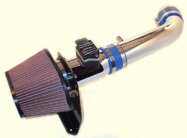

We carry the Mac Intake here at Explorer Express. We have the #3659 system for $134.95. This system replace the restrictive stock air box with an open air filter and nice chrome tube. It offers an immediate and noticable power increase. The performance equals the K & N and it is much more affordable. We also have these available for the 4.6 V8, 4.0 SOHC & 4.0 OHV (96-01)It is pictured here with the Pro-M 75mm (also available at Explorer Express).

I agree, the Mac's chrome plated pipe is going to be a heat magnet, plus it will pit in a few years. Has anyone looked inside of the stock hose? It's smooth inside, why do you need a metal pipe? If you have to have metal for looks get an aluminum one from Ifab on ebay.

I don't need a metal pipe, and I don't need more cold air. I want the engine compartment cleaner. If I wanted just cold air I would make my own kit out of 3" PVC. An added bonus of the CAI is less restricted airflow (more power) and I am willing to gain that.
Chrome will not pit if it is taken care of properly. It needs to be polished and waxed regularly and kept free from scratches.
I have a MAC on my 5.0 too and I love it! It looks great and sounds even better. Boosted my mileage too. It really makes the engine compartment look nice. And about the pipe, Ive gone on trips for 4 and 5 hours and you can still put your hand on the intake pipe without burning yourself. It does not get that hot at all. Ya also gotta love the hissing it makes when you tap the gas and turn the car off. Sounds like a jet engine!! I say go for that MAC!

i never had a problem with my chrome mac being too hot. i can completely wrap my hand around it right after a long drive with no problem at all. i mean, it's bringing in cold air, it can't get that hot or it's purpose will be defeated. i also agree that it looks killer. so much cleaner and sharp looking.
