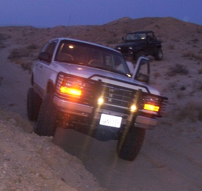

Its the nature of IFS trucks to not flex well up front. As others have already stated disconnect your say bars to get that extra inch or so of flex up and full downward flex out of the front of your truck. I just did a 6" lift on my 1st gen Explorer and it flexes the same way it did before the lift. Here is a pic of it at max flex with the sway bars connected. I would have a pic with them discoed but I just lifted it and trying to get a fell for the new center of gravity and all.
Notice the front axles are pretty much even with each other, and the back axle is doing all the flex.
