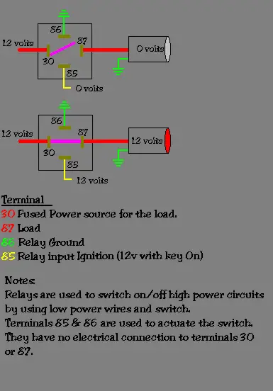

If you want switched power you will need to re-wiring the AUX. As such it would be a piece of cake to do by simply adding a 12v automotive relay. In the picture below you would need to cut the power source to the AUX and connect the ends (one to term 30 power side, and the other to term 87 AUX or load side). Terminal 86 is to ground and terminal 85 yellow wire will be to any wire which is hot (12v) when the key is on. Charlies suggestion works ok, but will cause a parasitic battery drain on your battery (when not running). If I'm reading your post correctly you want to use the AUX power and not permanetly wire the detector in. That being said you could always tap into the acc/on wire for the radio, but if you use the aux for any device using more power it will start to blow fuses.
