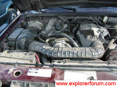

Went out to change the drivebelt on the Ex. When I removed the stock air outlet tube, I found it had chafed into one of my power wires. Repaired and repositioned the wires and tilted the tube slightly to gain 3/4" clearance between the two. It has been rubbing for some time now and was lucky to find it when I did. Might be a good idea to make sure your wires have lots of clearance and not touching like mine were.
http://www.explorerforum.com/data/503/8811chafed_wire.jpg
Sorry about the quality of the second pic. Never go drinking the night before you take zoom shots, or at least get a tripod then.
Good tip Bashman, my wires are already running away from the tube though, due to the police mods.....:)
Yeah mine were too. I found them like that when I broke the positive battery terminal, so I wrapped up the wire and moved them so they would not rub. My wire was exposed.
