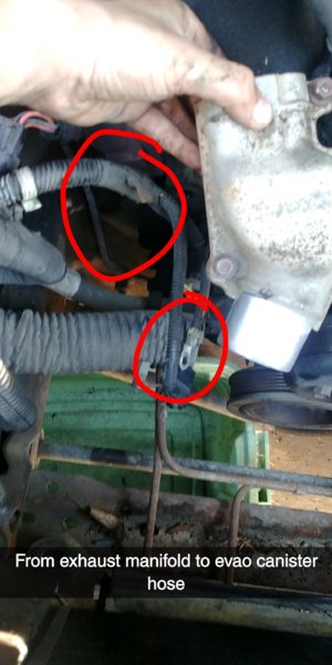

I found a picture from when i was doing my engine swap.
I believe this is the battery negative ground. This i cuurrently have bolted to the block, however i believe its supposed to be attatched to the frame?
