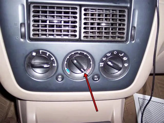

Before you installed the new actuator, what kind of air temp were you getting from the system, cold or hot? When these actuators go bad, they usually fail to the cold side of the system, meaning you get cold air but no heat. This means the blend door itself is sitting on the cold side of the system. When you go to test the new actuator prior to connecting it to the blend door box, you need to make sure the temp control knob is set to the coldest setting and when you go to test the new actuator, you then turn the temp control to hot, see the actuator arm rotate like it should, then re-set the temp control knob back to the coldest setting and leave it there on coldest, see the actuator arm rotate once more back to it's original out of the box position, which should be the cold position. Now it can be connected to the blend door box. I'm thinking you may have failed to rotate the new actuator arm back to it's original out of the box position prior to connecting it to the blend door box or you had the temp control knob set to the hot temp side when you tested it. The actuator arm is in the wrong position to turn the temp blend door in accordance to the temp control knob setting. Do you follow me? If you failed to reset the actuator arm back to it''s orginal out of the box position during testing, you may need to disconnect the new actuator from the blend door box and energize the ignition while it is out, and rotate the actuator arm by turning the temp control knob back to the other position and leave it there and re-install it and see what happens. One other thing you could have going on is a bad blend door itself, meaning the hinges that this blend door flip back and forth on are broken, and the door won't rotate either way. Usually it is just the actuators that go bad. On the calibration thing from the mechanic, don't know for sure, but it sounds bogus to me. May just need to re-install the new actuator/arm in the correct position. Hope this helps!

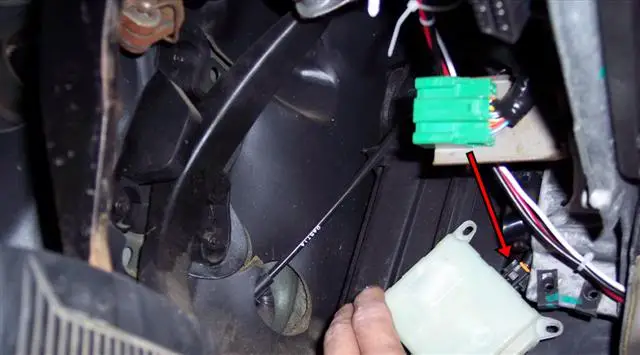

From my write up on changing the BDA:
7. Install New Blend Door Actuator
7.a. Connect actuator
7.b. Turn ignition key to run position
7.c. Rotate temp selector from cold to hot to verify operation of actuator – shaft should be moving
7.d. Rotate temp from hot to cold setting – shaft should be moving – leave temp set to cold
7.e. Wait for shaft to stop moving! Then turn ignition key to off and remove key - LEAVE TEMP SET TO COLD
I don't know of any calibration requirements. :dunno:
