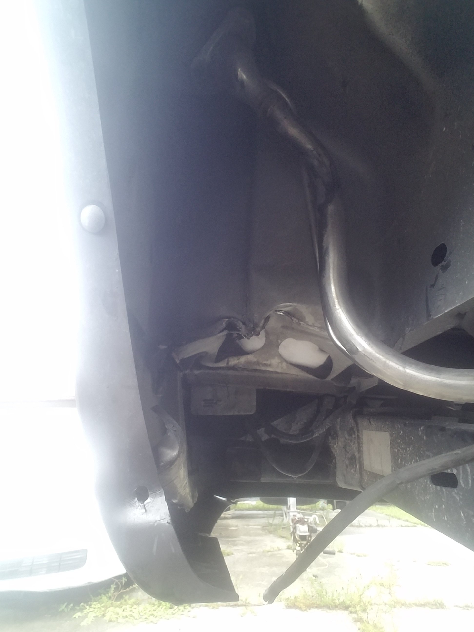

I had a rear passenger tire blow out the other day and when it blew, it knocked loose to vent lines and whatever they were connected to. One of them was the rear and that line and the other line looks like it is coming from a dust collector coming off of the gas tank. They were both connected to something behind the rear passenger tire. Now my truck won't start. I tried replacing the inertia switch and that wasn't the issue. Can anyone help?
Are the wires OK under there? I was gonna also say hit the reset switch on the fuel reset inertia thing.
Form your pictures it looks like your blown tire ripped off all of the lines for the Gas Tank Purge canister.
Now your drawing excess air into the intake the engine has no idea what to do with.
