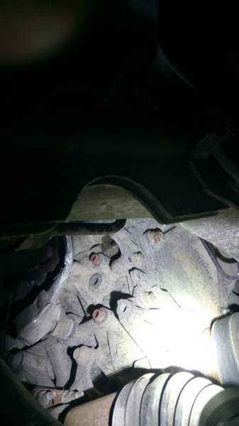

HI Ted22, may I request if you Can send me a picture of this old plug please, my email address is ferdinand_quing@yahoo.com.. I have a picture here but looks like it's not right, I include a picture in this message,.. Thank you
I have not installed one so I am no help for that part.
The post you are refering is from 2015. He might not be on here any more.
Its ok, thanks for replying.. I will message Ted again maybe he can send me a picture.. Have a good afternoon.

Hi Peter, good evening.. Is it possible that you can send me a picture where is this block heater location please? Mine is 2013 and Ted said he put 1 in his SUV and looks. Like it's also 2013 model... I check everything but I haven't seen any wire for the block heater..and thanks for letting me know Ted last post is 2016
Here is a picture of it in my previous 2011 Limited. Also, check my post #12 in that thread. Hope it helps.
Block Heater question?...
Peter
Hello Peter, thank you very much for your help with the picture, I thought that is a radiador fan wiring, I didn't see the plug because its under the big rubber hose.. Have a good night..
