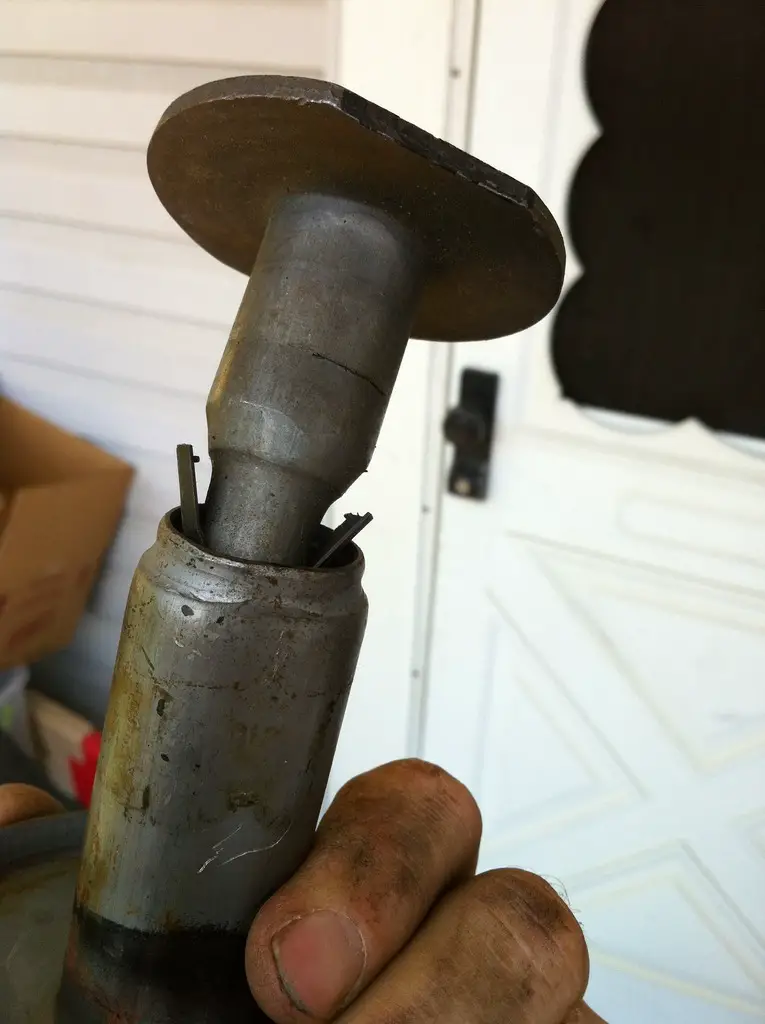

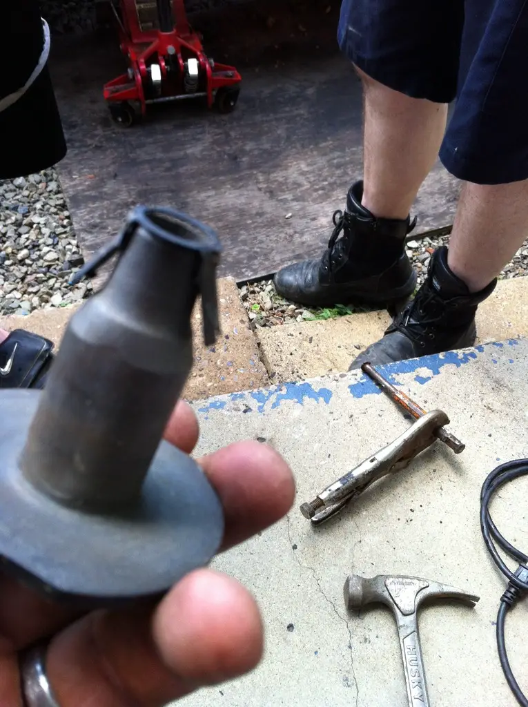

IIRC, 2001-03 two door Sports use the same lower "C" pillar lower bushing that has "locking tabs" that should be compressed for removal.
See pics from the link below to see what you're fighting. Using 1/2" electrical conduit that's mentioned sounds like a good method. GL
