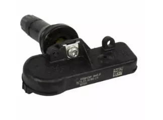

The image is of someone elses car but its essentially the same layout with the addition of my tire pressure light going off due to my inability to connect my wheels to my wheel sensor ( THE TIRES ARE AFTERMARKET AND I CANNOT FIND ANY SENSOR ON THE WHEEL) im going to check this thread again on friday by 5pm EST.

Are you the original owner? The TPMS sensors are part of the tire valves.

As Peter mentioned, the TPMS pressure sensors are screwed onto the valve stems, but if you didn't have this problem immediately after swapping in those wheels, then possibly the sensor battery has drained flat. The battery is not user replaceable.
