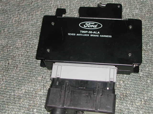

I'll do a postscript if you want showing the tool and how it is used. It wasn't needed on this job because the 92 is a rear ABS system only and we were just doing the front without bleeding. I have that "expensive tool" (have a couple for sale for $75 each) and can show you how it works.
I like to both show visually how some things are done, and also show how us home guys can "DIY" some things the manuals say we cannot (like the A4LD Rebuild Diary). That pump tool isn't all that expensive, as you can see.

Well, let me show you the Rotunda tool. I picked it up on E-bay when I bought some misc stuff ... didn't pay much for it (lucky me)...
Here is the 90-050-ALA adapter. It hooks into the PCM.
Here is the business side...
I have two Thexton adapters that do the same thing... just do not give you the harness (bypass) position. Still skeptical? They are out there... and at reasonable prices. Bleeding ABS systems CAN be DIY.
Let me PM you on the output shaft 55W vs 55E
