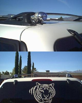

I am currently doing a reverse light mod on my Ex. They are going to be mounted to the furthest back part of the stock crossbar on the roof. Dead Link Removed

Here is a shot of mine mounted on the roof.

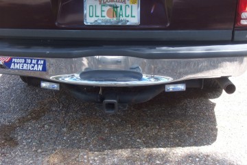

I bought my 50watt backup bulbs at Pep Boys for $6 apiece on sale... thay work great for everyday use. I have a set of Blazer fogs mounted like Digger196, except mine are mounted on the bottom of the plate so I don't rip them off on trees and crap...

Fricken' awesome posts here guys. I like what Aldive has done, it seems that it wouldn't create much of a drag - and it they wont be ripped off when I run two tracks with all those trees! So Aldive - was it tricky to install them???

The install was simple. Drill the mounting holes on bottom of rear bumper. Then run the wires to the drivers side taillight housing. Ground the negative lead to thye frame and splice the positive into the wire for the reverse light. Thays it......They work great.
Good luck doing yours.

I am putting mine on top, using my Auto/On/Off schematic which is truely one of the biggest PITA I have done wiring wise.

I finished mine. They are on the roof. I will post some pics tomorrow.
