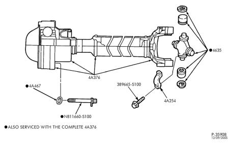

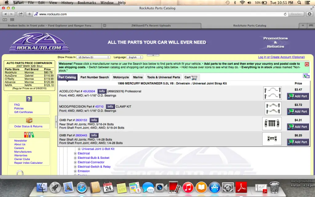

Man, I really appreciate it, I had found the straps on o Reilly website earlier, can't remember the lengths, checked there and rock auto for the yoke, I have access to an impact and all that, just wasn't quite ready to tear the diff completely down till I'm ready to 're gear this summer. Would like to get awd going, I'm only home like a week out the month, so I normally order everything so it's there when I'm home and just do the work when I get there
You're welcome.
What was the sizing and length that OReilly was showing?
Also the front pinion flange isn't on rockauto, only the rear. I had looked there already previously and numerous times now today. I just sent them an email about the bolts.
There is a good chance that you won't be able to break loose that front pinion flange nut with just an impact unless you have a strong one. I had to use my big one to break the rear one loose, not to mention if you are going to try and count the turns, you really almost have to do it by hand.
When I did the rear, I not only marked and counted the rotations, I also measured the distance that the pinion was sticking out of the nut just to make sure in case I lost count or to double check. My pinion seal lasted a few weeks which is why I finally decided to tear it down and do it all the proper way with a new crush sleeve. Some have gotten by with it, others ruining the pinion bearings but like I said the rear is easier to do in the truck than the front.
