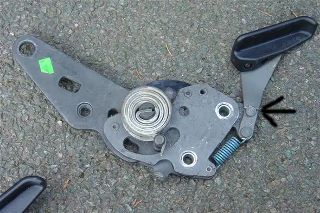

For those of you who have broken the recliner lever.
The first picture shows the old lever mechanism and where it breaks.

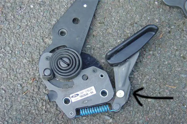

The second picture shows the new modified and strengthen part from Ford.

Well I looked at repairing it but as the break was right at the pivot I thought it best to replace. I got the new part from Ford dealership at a cost of £64 (which is about $130 can) so at least i know that this time i was not ripped off. Fitting is very easy just 4 bolts (two on the squab part and two on the upright). The only bit that is hard to reach is the top bolt on the back of the seat. In standard Ford fashion the bolts are not all the same and you will need a torx (45) for one bolt.
I checked with fords part network and the cost is $59.99 my freight is another $25 US then there is customs they have to get there share! so it works out to be about the same as the dealer is quoting me here at $130 cdn. Anyway, thanks "Premier", but anyone who needs this part from the fords part network the part number is:
XL2Z-7862649-AA. There is another thread about this and it quotes the wrong part number! so I hope this helps someone else.
