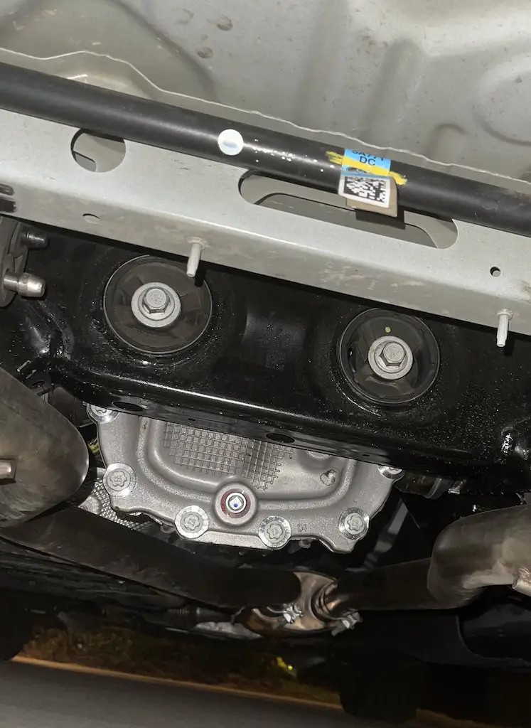

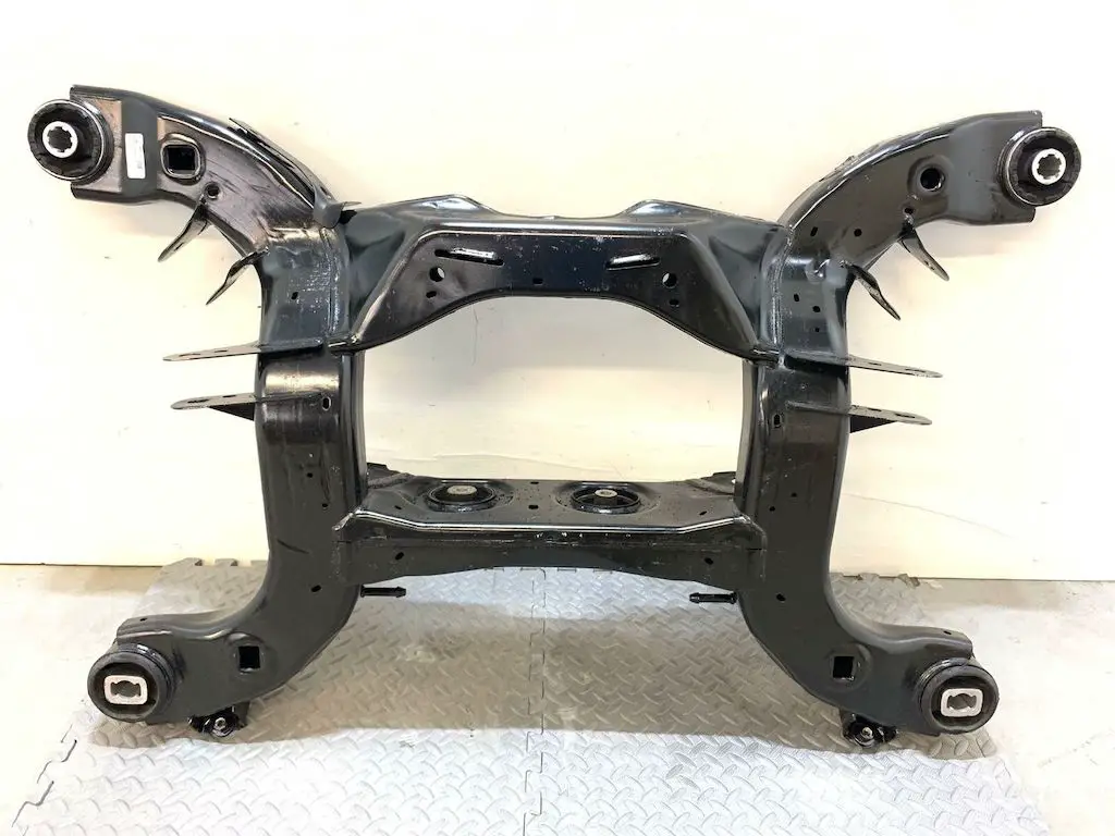

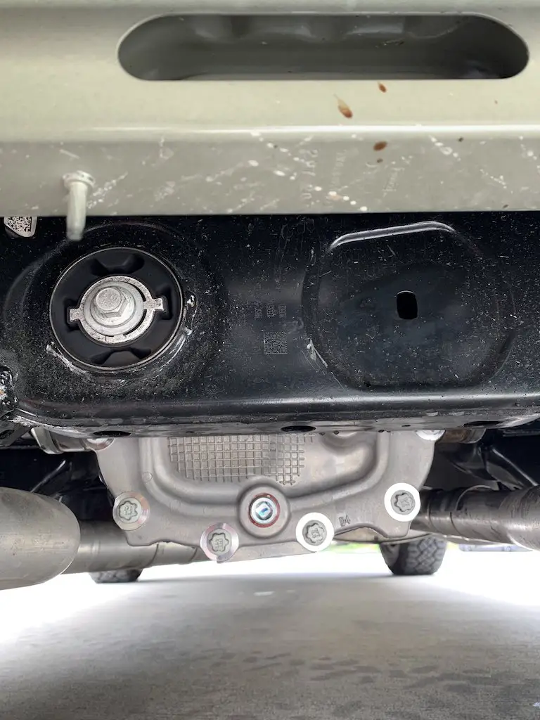

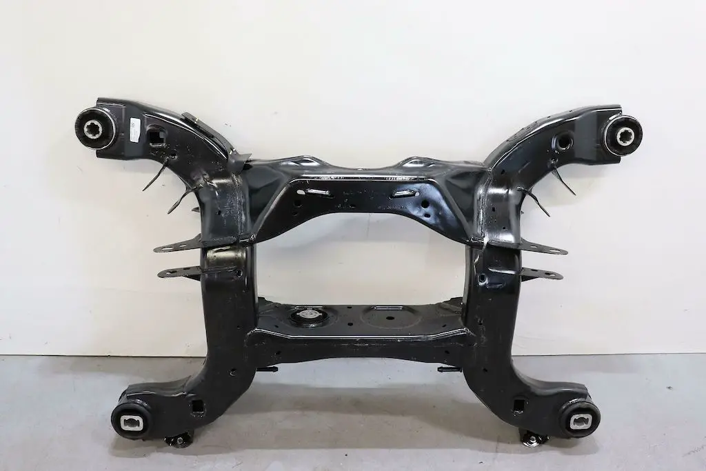

A problem has come up with MY2021 STs and quite possibly all the 3.0L Ecoboost variants where Ford has chosen to substitute the 2.3L rear subframe (ie. One Bolt) for the 3.0L rear subframe (Two Bolt) that is supposed to be there. Please respond with what you have. I believe the change was made in early 2021 (~feb/2021). The problem is the One Bolt is proving to be insufficient for the 3.0L drivetrains and that bolt is snapping. In the comments section, list your build date, what subframe you have and what model. Only MY2021 MY2022 3.0L Ecoboost models please. The one vs two bolts can be seen when looking directly underneath from the rear of your vehicle. It is right behind the rear differential.
2.3L rear subframe:
3.0L rear subframe:
The damage from a sheered off differential mount bolt on the "One Bolt" is not insignificant. It may include but not be limited to driveshaft, rear differential, rear drive axles (one or both). So far there's one report of the Dealer keeping the existing subframe after repairs but in another report, the subframe was also replaced with the correct "Two Bolt".

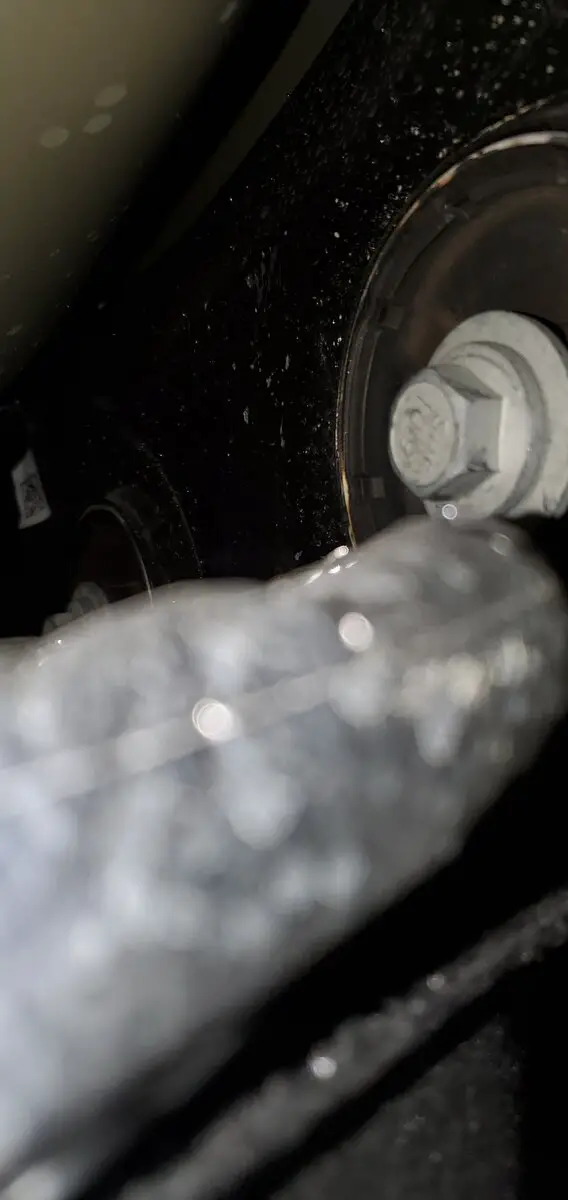

Crawled under our 22 Aviator GT and shoved the phone around the air deflector... looks like its a 2 bolter. 10/21 build.
