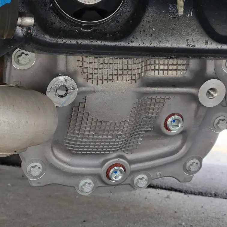

Here is a pic of a failed one bolt with the differential dropping down.
I would be more concerned about that crappy casting on the left side of dif cover.
I think what you are referring to is the area around where the diff mount bolt sheared off and damaged the housing.
As mentioned, there’s no casting issue, just failed engineering choices.
