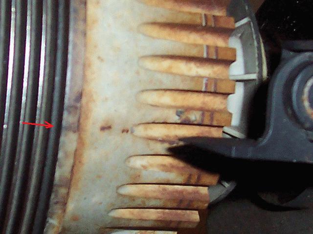

There are two timing marks (lines) on the damper: 10 deg BTDC and 0 deg TDC (red arrow). Neither valve will be depressed when the crankshaft is at TDC on the compression stroke. If the driver side valve cover is off the "nub" on the camshaft for the camshaft position sensor will be above the axis of the camshaft.

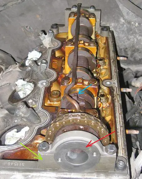

Many people forget that the rear camshaft sprocket retaining bolt loosens clockwise and tightens counter-clockwise. Also, if the lever tool in the timing kit is used it multiplies the torque so a lower value should be applied.
