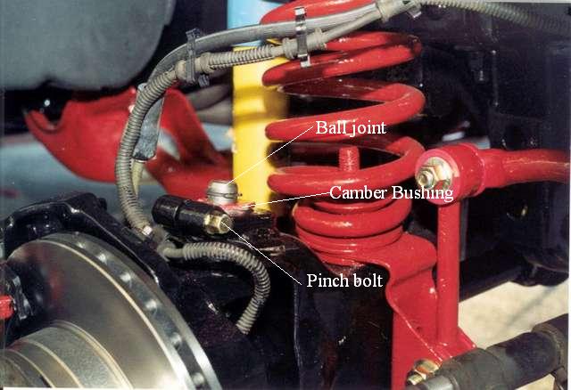

Just an fyi the link above doesn't represent a 1st gen explorer Camber bushing setup..
1st Gen dana 35 TTB. The camber alignment bushing is in red. You just need to remove the pinch bolt and clip on the ball joint. Then use some screwdrivers to evenly tap the bushing straight up and off.
