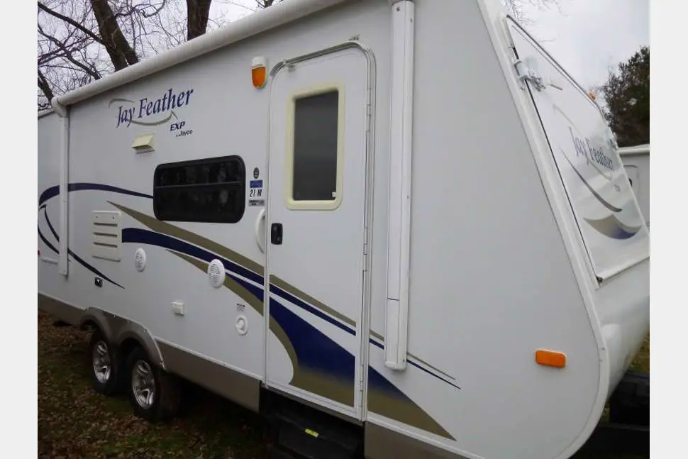

I just brought a 96 ford explorer 2wd auto. well i'm planning on installing a hitch because I have a camping trip in november. I'm looking at three trailers. Its going to be me, wife and two kids. Does anyone know if it can pull it any of them?. I know the motor is a v6.
21ft
31ft
25ft

I'm not sure if OP mentioned whether he was looking to buy new or used but I WOULD NEVER buy a brand new rv. The depreciation is just too large. Trailers like the ones picturedo can be bought not too old in great condition in the $10k range all the time. That's a small investment compared to what new truck prices are ( and imho those new truck prices have gotten absolutely ridiculous ).
