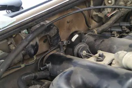

which intake system?
Does your engine have the variable intake system (VIS)? See: VIS Conversion
It was only used on 1997 and 1998 SOHC V6 engines but someone may have swapped your engine or intake manifold. Your 1999 electrical system does not support VIS which changes the length of the intake runners at 3,000 rpm.
nah mine is ohv 99 and engine hasn't been swapped
