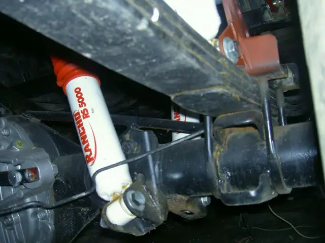

I did a SOA about six months ago and my set up was exactly like josh's pictured. I figured I could just mount it up and lose a little travel, keep it that way for a while until I figured out what I wanted to do.....I lost nearly all my travel....bottomed out on everything. It got old fast. I drove it that way for less than a day. I ended up mounting the mottom of the shock to the sway bar mount. worked out perfect. I have not noticed a difference not running a rear swaybar...here's a pic:
overkil what kind of bolts did u use to mount the the bottom of the shock to the bracket, the stock ones? if they are pretty lucky they fit huh.
Overkill, I am curious how exactly you mounted the shocks to the sway bar mounts... Did that require any welding because it sure doesn't look like it did but just want to make sure because if not I might just bolt the shocks up there if it is that easy. Also are the top of the shocks still mounted in the factory location or did you relocate them?
One more question for you Overkill... May I ask where you got your skyjacker 6" lift for the front of your car? I am looking for the same lift kit for the front of my Explorer and I won't need the rear lift since I am just going SOA in the rear.
Ok, let me see if I can get everything straight here. That picture of my rearend is an old and outdated one. I had my shocks like that for a while, and like Overkil, got tired of it quick. It bottoms out over anything bigger than a pebble, and rides horribly. The stock shocks in that location have about 1" of uptravel before they bottom out. I do not recommend mounting them this way.
You can bolt the shocks to the upper swaybar bolt hole with the swaybar still attached and with the stock shock bolts. All I did was drill the swaybar bracket out a tad to fit the bigger shock bolt. This is a perfect setup, and has worked great for me.
