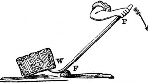

beach - Yes, the alternators are a TIGHT fit.
You won't be able to pull it out by hand.
Put a "lever" under the Alternator, and a work it CAREFULLY out from it's mounting points.
You might even have to put a small block of wood under the lever to get some more "ommph"
The block of wood will lessen any chance of damage to the "foundation" that you're levering off of.
I have a small gooseneck wrecking bar that I use for this - the end on the left side of the picture is what I utilize.
