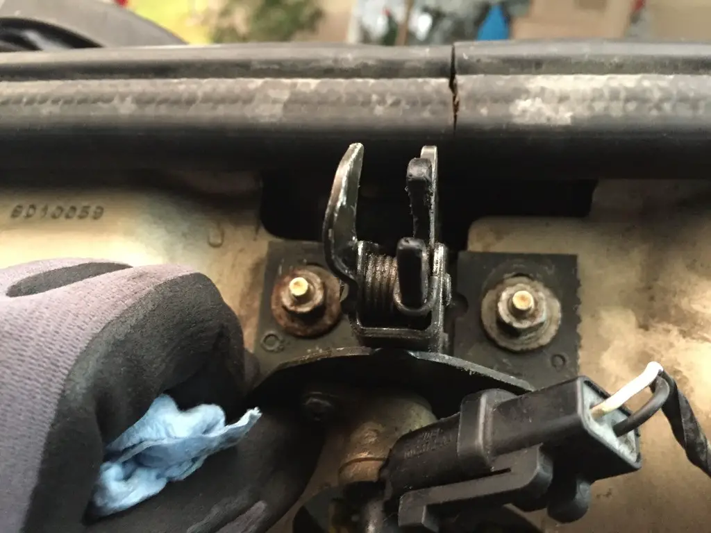

I had the same issue with my 2000. The rear window was stuck shut for years after a tv that wasn't tied down slammed into it. I removed the door trim by cutting the small plastic strip under the window latch. You'll know what it is as it's the only thing that keeps the door trim on after removing all other panel clips, and unfortunately you have to cut it if you can't open the rear window. Well after that's was off, I saw that the window latch had been pushed towards the rear of the vehicle from the impact of the tv hitting the rear liftgate. Here's the window latch before I loosened the bolts to adjust it:
I simply loosened the bolts and brought it towards the front of the vehicle will trying to keep it straight. This is what it looks like in the correct position:
Hopefully this helps as it fixed my rear window issues and I can open it again after years of not being able to use it. Good luck.
